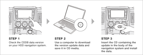

On this page we will explain how to update the music CD data (Gracenote database) for your HDD navigation system. The procedure is outlined in the following illustrations.
This will complete the music information update process.
*Before performing this update, please read all warnings and instructions described below, and make sure you understand them.

Step.1 Check the HDD navigation system data version (perform this step in the vehicle).Check the version of Gracenote database.
1. Check the vehicle's HDD navigation system CDDB data versions.
2. Press the [INFO] button.
*Screenshots may show items that are not displayed in some vehicle types.
3. Select [Support Info]*.
*The screen shown appears when English is selected. The screen will vary depending on which language setting you select.
4. CDDB version information will be displayed as [xxxx-xxxx].
Please take a note of the number of the version information.
*The screenshot shows one example; actual screens may vary depending on the make of the vehicles.
5. Press the [NAVI] button to return to the first screen.
Step.2 Save the version update data to CD-R or CD-ROM CD media (perform this step with a PC).
Download the version update from the "Data download" on this page and save it to a CD.
1. Find the download buttons at the bottom of the "Data download" page.
2. Click the "Download" button (select Windows or Macintosh).
3. Save the target file "xxxx.ext," where "xxxx" is the version number and "ext" is the file extension, to a location of your choice on your computer.
Extensions
Windows (Recommended)Macintosh (Recommended)
xxxx.zipxxxx.sit
4. Decompress the downloaded file.
Decompression method
For xxxx.zip files,
use software that supports the zip format.
For xxxx.sit files,
use software that supports the sit format.
*The update data in the zip and sit files are identical.
5. Save the decompressed data from step 4 to CD-R or CD-RW media.
After decompressing, save three files with the extensions ".UDT" ".UDX" and ".TXT".
*The file extensions might not be displayed depending on your PC settings.
To display file extensions, open "My Computer," click the "Tools" menu, then select "Folder Options." Click the "View" tab and uncheck the "Hide extensions for known file types" option (Windows only).
6. Confirm that the ".UDT" ".UDX" and ".TXT" files were correctly written to the CD-R or CD-RW created in step 5.
Step.3 Load the version update data (perform this step in the vehicle).
Load the version update data from the vehicle's HDD navigation system.
*If the vehicle battery is low due to cold weather, the battery may become drained during the update. To prevent this, turn off any devices that use the battery, such as lights, air conditioner, etc., and perform the update with leaving the engine running.
1. Turn the engine switch to the ON position.
Power up the MMCS and display the map or AV screen.
2. Insert the disk containing the version update.
Insert the version update disk created in Step 2 in the disk slot.
3. Press the "MODE" key to display the AV MODE screen.
The AV MODE screen will be displayed. When the version update disk is detected, a button labeled [CDDB Updating] will be displayed in the lower-left corner of the AV MODE screen.
The ‘AV MODE Selection screen’ shown on the right appears in the 2007 model. Although the ‘Back’ button appears on the bottom right of the screen in the 2006 model due to a defect, the screen will not change even if you click it.
4. Touch the [CDDB Updating] button.
A version update progress screen will be displayed, and the update will begin. The version update will take about 3 minutes. Please wait until the update is completed.
5. Remove the disk.
When the version update is completed, a message reading “CDDB update has completed.”* will appear on the screen. The screen will automatically return to the AV MODE screen. Please eject the disk.The updated version of the Gracenote database will be displayed on the INFO screen under “Support Info”* You can check that the update has been successful by confirming that the last four digits of the CDDB data version match the version you installed.
This completes the Gracenote database version update. You can now use the database as usual.
